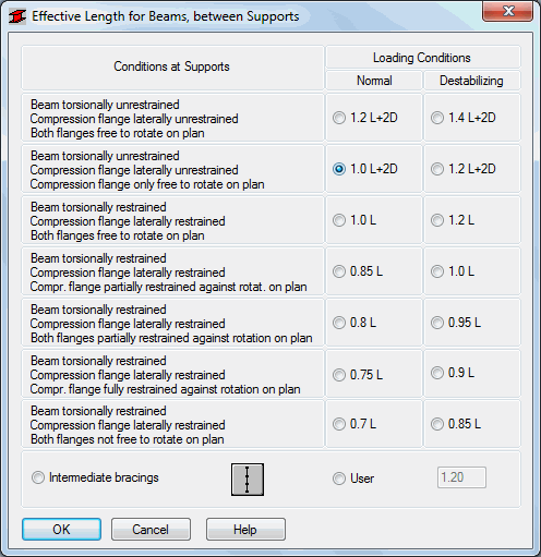

The option allows you to define distances between member cross-sections protected against torsion, that is the lateral buckling length for beams. To access the option:
The dialog displays Table 15 from IS 800.
At the bottom of the dialog is the Intermediate bracings option. Select this option and click
to open the Internal Bracings dialog.
