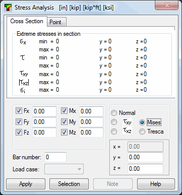

Select the Cross Section tab in the Stress Analysis dialog to display the extreme stresses obtained in the selected bar cross-section.
This dialog includes the following extreme stress results, calculated in the selected longitudinal bar section:
Each stress value displays with a coordinate for which the extreme stress value was calculated.
