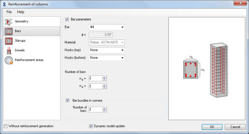

Parameters of longitudinal reinforcement include:
Use the Bar bundles in corners option to increase the reinforcement area. If it is impossible to increase the number of reinforcing bars keeping appropriate spacing between them, you can use bar bundles (2 to 4 bars in a bundle) in corners of the cross-section.
