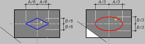

Core I
Core 1 prevents a gap under the foundation base, which indicates uplift. In this case the eccentricity may not exceed the values A/6 and B/6 so the neutral axis does not intersect the foundation base.

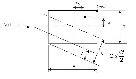

Core II
The generalized core has been introduced due to the limitation of allowable gap under the foundation when uplift of the footing base occurs 2.3 a. The code allows for the gap between the ground and the foundation base. The range of which may not be greater than half of the distance C', between the straight line that extends parallel to the neutral axis and passes through the centroid of the whole base, and the outermost point of the base which lies opposite to the point at which the maximum stress value q rmax occurs. Therefore, the allowable, relative value of a gap for core II equals 0.5 and results from the C/C' ratio. For a simple case of eB = 0, C = A/4, a C' = A/2.
