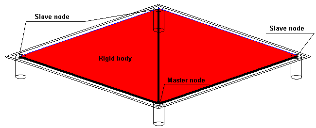

Defining a rigid link between nodes is the same as introducing rigid compatibility conditions with respect to all displacements in these nodes. All nodes linked with a master node constitute a group of nodes comparable to a rigid body.
For example, linear displacements can be blocked, while rotations can be allowed. The first node is the master node, while the remaining ones are slave nodes.
The use of rigid links can be illustrated by defining a floor which is rigid in its plane, whereas, in the direction perpendicular to the floor plane, it is pliant. A rigid link is defined as a rigid membrane linked with a master node, to which slave nodes with a selected set of degrees of freedom are attached. (To achieve full rigidity, all degrees of freedom for the slave nodes should be selected.) When using rigid links, it is possible to model a membrane (see the following image) - the directions UZ RX RY RZ in the slave nodes are released.

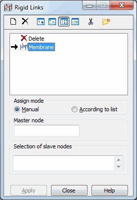

Open the Rigid Links dialog for defining the rigid links in the structure, using either method:
The Rigid Links dialog box has the following elements:
At the top of the dialog are the following:

Similar to defining other attributes, the definition of a rigid link has 2 steps:
If the active rigid link type list is empty or a new rigid link type is to be added to the active list, click New Rigid Link Definition:
Also, you can open the dialog for defining a new rigid link by double-clicking an element in the list of rigid links. The Rigid Link Definition dialog opens with all fields filled according to the rigid link type selected. Click Add (or press <ENTER>) to add (update) the new rigid link type to the list. If the label does not change, a warning message is displayed.
