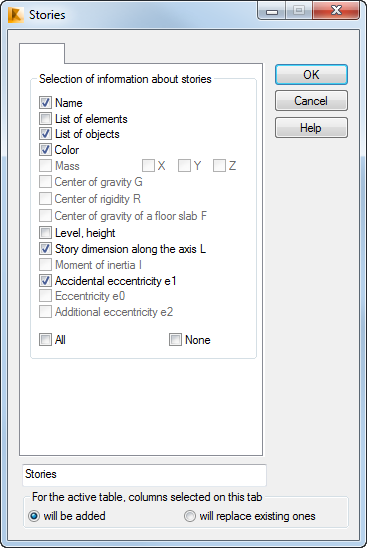

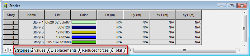

In the Stories table, you can find values describing story properties and the results associated with them.
In the Stories dialog, you can select which of these properties or results are displayed in the Stories table.
Stories to open the Stories table, and then click View
Table Columns to open the Stories dialog.
Stories to open the Stories table, and then right-click in the Stories table and select the Table Columns from the context menu to open the Stories dialog.
The content of the Stories dialog is common for Stories, Values, and Total tabs, but some of options are available for an appropriate tab only.

The Stories tab displays the geometrical properties of each story: list of objects and elements of a story, color, level and height, story dimensions Lx, Ly, and the values of accidental eccentricities ex1 and ey1.

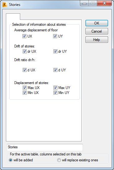

The Displacements tab displays the maximum values of nodal displacements projected to the X and Y axes as well as values of drifts dr Ux, dr UY.
The drift of stories is calculated as the difference of the average displacement of the gravity center of a story slab of the subsequent stories. As in the story slab gravity center calculation, the average displacement of the story slab gravity center is weighed by the weight of the slab objects. As an example, the averaged displacement in the X direction, UXF = SUM(i) (UXi * Wi) / SUM(i) Wi, where the UXi is the displacement of the UX gravity center of the i-finite element, the Wi weight of a finite element.
The drift ratio d = dr / h is also presented in the table, where h stands for the story height.

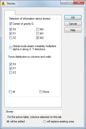

The Reduced forces tab displays forces in a section through a story (a cut through panels and members) reduced to the center of gravity.
Results are displayed by load cases and successive stories (first column). The next columns show the following information:
Total reduced forces for a story are calculated based on external loads applied to nodes of the story. If loads are applied to objects such as columns or walls, Robot considers forces distributed to nodes of a member or to nodes of a finite element mesh of a panel. As a result, loads applied to nodes at the lower level of the story are ignored in the sum of forces for a story.
Nodal loads are reduced to the center of gravity of a story. Thus, forces and equivalent moments in the 3 directions: X, Y, and Z are obtained.
Reduced forces per columns on a story are calculated based on internal forces in the member cross-section. The cut is parallel to the XY plane of the global coordinate system at the level of the bottom of a story. As a result of the reduction, a set of 3 forces and 3 moments reduced to the center of gravity is obtained.
Reduced forces per walls on a story are calculated as a difference between the total reduced force for a story and the reduced force for columns.
