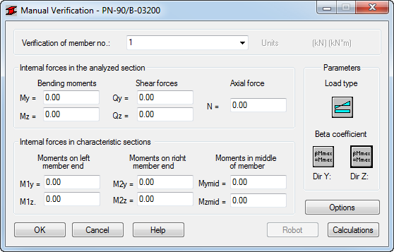

The Manual Verification dialog provides steel member verification against force values defined according to the Polish Steel Code PN 90/B-03200. Access the option by clicking Design
Steel Members Design - Options
Verification. The following dialog displays:
To run steel member verification based on predefined internal force values:
Corresponding units are displayed in the right upper corner of the dialog.
Once the icon is clicked, a dialog for the load type definition displays.
