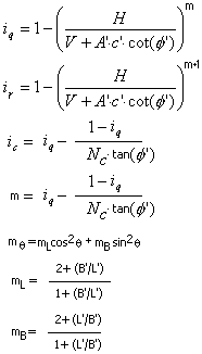

Non-dimensional coefficients of inclination of a load induced by the H horizontal force equal:

Dimensionless factors of the load inclination resulting from the horizontal force H parallel to the longer and to the shorter sides, respectively, are equal to:
