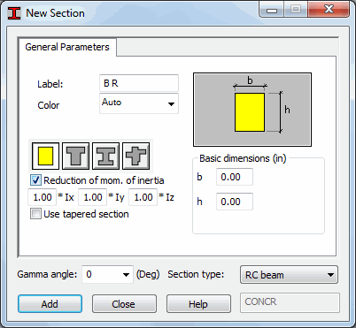

After clicking
on the Section dialog, a new dialog is displayed with the following tabs:
Available cross section types include:
For example, the New Section dialog for an RC beam displays as shown in the following image:
The Section dialog lets you:
You can select 1 of 4 types of beam/continuous footing sections: rectangular, T-shaped, I-shaped, and T-shaped with lower-positioned flanges. The dialog displays the parameters for the type of section selected. The previous dialog shows the parameters for a rectangular section. Similar options are displayed in the dialog when a T-shaped section is selected. After a T-shaped section with lower-positioned flanges is selected, 2 additional tabs display in the dialog: Slabs and Cuts.
