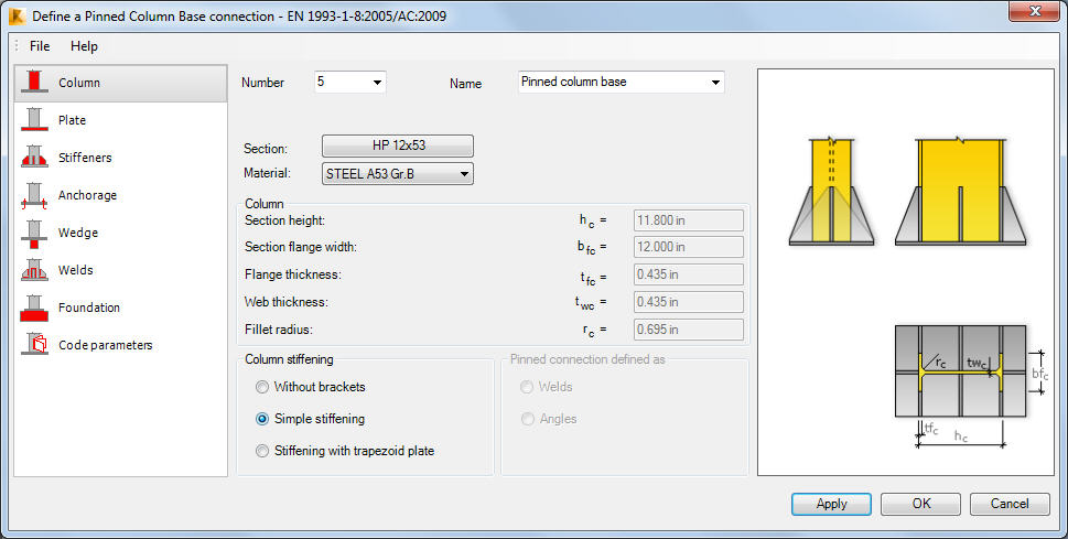

Use the Column tab to define basic parameters of the column-foundation connection.
If any of stiffening options is selected, you can additionally select Stiffening with top plate option.
If stiffening is generated in the connection, the Stiffeners tab display in the dialog, where you can define parameters of stiffeners.
