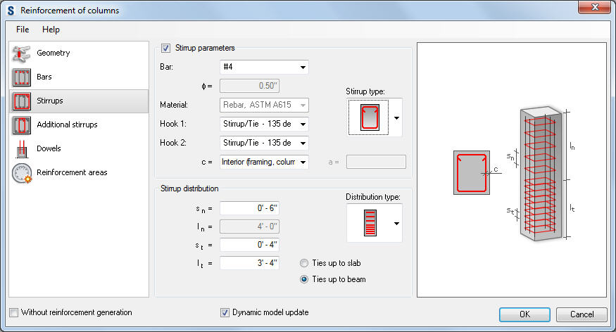

There are several parameters of transversal reinforcement (stirrups) defined in the Reinforcement of columns dialog:
uniform
distribution zone with denser spacing in the lower part of the column
3 zones of stirrup distribution (denser spacing in the lower and upper parts of the column)
