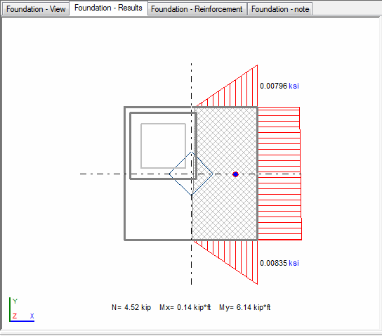

Once spread or continuous footing calculations have begun, the Foundations - results layout is enabled by default. The layout includes the graphic viewer displaying the spread /continuous footing (with obtained results, the results for the soil, and the Foundation - results dialog.
Select Results > Calculation Note to view the calculations textually.
When designing a footing, the following values may be presented:
For distribution of stresses under the foundation, values of forces and moments acting directly at points of foundation-soil contact are displayed.
When designing a continuous footing, the cross-section of the foundation and the diagram of stresses in the soil underneath are presented.

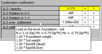

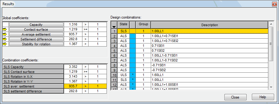

External load combinations (external loads are loads applied to the pier or to the top surface of the foundation) for which the designed spread or continuous footing was verified are presented in the Design Combinations field. The following information is given in this field: combination type (ULS, SLS), load group, and a number of a load multiplied by the appropriate coefficient. Combinations marked with an asterisk refer to combinations used for RC calculations (reinforcement, punching, etc.); combinations without an asterisk refer to combinations used for soil calculations (soil capacity, stability for overturning, and so on). Values of forces and moments including the self-weight of the foundation display under the drawing of the stress distribution in the Foundations - Results dialog.
Safety factors for the active load combination (highlighted in the Design Combination field) are presented in the Combination Coefficients field. All verified combinations for the active design combination are given in this field. The description contains: the combination type for which the verification was carried out and the real value of the coefficient value in relation to the limiting value. After you click one of the coefficients, the drawing of stress distribution displays the solution for that coefficient.
If the coefficient value is expressed with the INF symbol (infinity), this condition does not occur for the designed spread or continuous footing. The applied loads do not cause a rotation of the spread or continuous footing.
Six buttons are found in the Global coefficients field: Capacity, Contact surface, Stability for sliding, Stability for rotation, Average settlement and Punching/Shear. The most unfavorable coefficients for the appropriate types of the spread / continuous footing verification are presented in the fields to the right. Clicking on the selected button results in highlighting the combination for which the presented safety factor was obtained in the Design Combination field.
