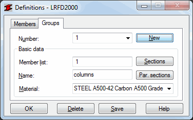

Use this option to define bar groups. Access the option by clicking the second tab in the Definitions dialog. The following displays:
Group Design and Optimization is performed in groups. Hence, when the user is verifying bar sections, group definition is not necessary. If, however, design or optimization procedures are planned, groups must be defined. The basic reason for grouping bars is the need to obtain one section for all bars once the design is completed. Hence, the most frequent requirement employed in group creation is the identical bar structure function - exterior columns of industrial halls, main floor beams, etc. These elements should be made from one type of section.
Use the buttons in the dialog to:
Basic Data
