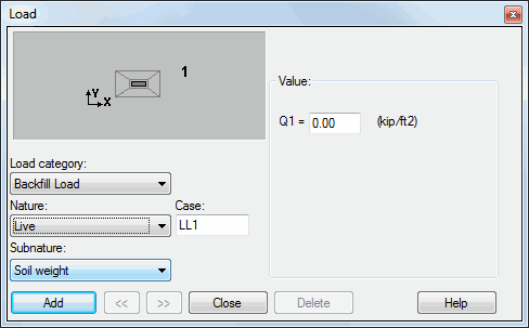

Available load categories contains two items: the foundation load (resulting from one or two columns) and the backfill load. The dialog in which the backfill load may be defined is shown below.
In the case of a backfill load, the value of the load Q1 should be entered. Two natures are available: dead and live.
