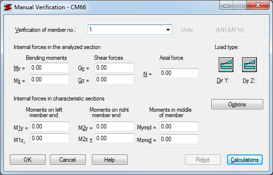

The Manual Verification dialog allows for steel member verification against force values defined according to a selected steel code (French CM66 code, German DIN code, Eurocode 3, among others). Access the option by clicking Design
Steel Members Design - Options
Verification. The following dialog displays (the image presents the dialog for the French CM66 code):
