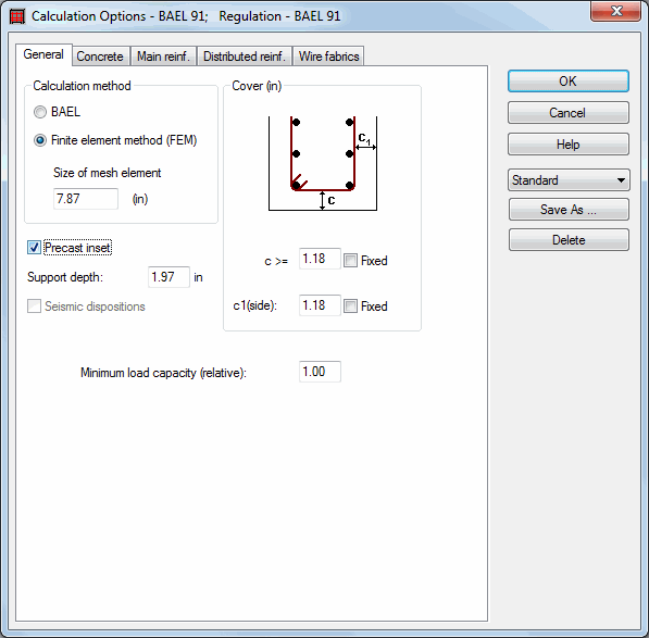

Once the Calculation Options dialog box is opened for deep-beams and the General tab is selected, the dialog box shown below will appear on the screen.
In the top part of the dialog box the calculation method for deep-beams may be selected:
Limitations of the method:
The maximum difference in height between the neighboring spans equals 1 m.
The distance between an opening and the deep-beam edge cannot be less than the opening width.
A detailed description of principles of the deep-beam modeling by means of the BAEL simplified method is given in the topic Calculation of deep beam reinforcement - principles.
A detailed description of principles of the deep-beam modeling by means of the Finite Element Method is given in the topic Principles of deep-beam modeling by means of FEM
