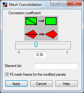

If you created a mesh of finite elements for a selected panel, it is possible to change it easily:
To open the Mesh Consolidation dialog, use either of the following ways:
Use this option to define the parameters of transforming the triangular finite elements into rectangular ones. Such transformation reduces the number of elements. It is recommended that you apply the Consolidation option after creating a mesh of finite elements by means of the Delaunay triangulation method. By transforming triangular elements into rectangular ones, you can receive more precise calculation results. Before running the Consolidation option, you must define:
If you use +1 as a coefficient, rectangles are created from triangles in all possible places within the indicated area. This, however, can generate rectangles with incorrect shapes resulting in the ill-conditioning of a set of equations. If you use -1 as the coefficient, only those triangular elements that form a rectangle are changed.
At the bottom of the dialog is the FE mesh freeze for the modified panels option:
