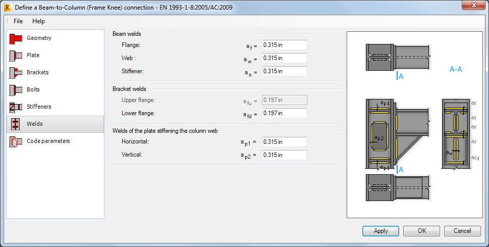

Use the Welds tab to define the thickness of welds connecting the beam with the front plate and the thickness of welds connecting stiffeners and the plate stiffening the column web.
This tab is available only if Welded connection is selected on the Geometry tab.
Thickness of the beam welds:
Thickness of welds of (upper and lower) brackets
Thickness of welds of the plate stiffening the column web:
