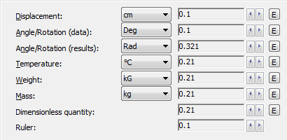

Click the Tools menu > Job Preferences > Units and Formats > Other to open the Units and Formats - Other dialog.
Select the units of measurement to be displayed in Robot.
You can also define the format of dimensionless quantities and the numbers appearing in the title bar of the Robot graphical viewer.
Use ![]()
to format the number of decimal places for each unit of measurement. Click E to switch between decimal and exponential formatting.
