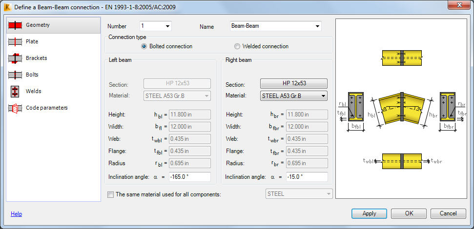

Parameters of geometry of the beam-beam steel connection include:
Geometrical and material parameters of beams for which to create a connection, display in the center of the dialog.
After selecting The same material used for all components, beams are made of the same material.
