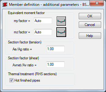

The option is used to define additional code parameters of a steel member type for the British code BS 5950:2000. It becomes accessible by pressing the More button in the Member Definition - Parameters dialog box.
The following additional member parameters may be defined in the above dialog box:
In the bottom part of the dialog box the thermal treatment method for RHS sections may be determined. If the option is switched on, the program treats RHS sections as hot-formed sections.
