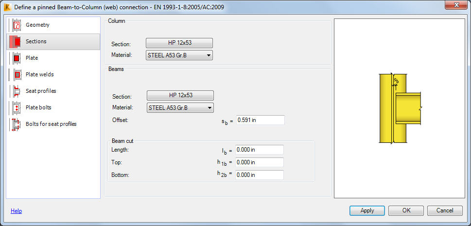

Use the Sections tab to define sections for the column and beam in the connection.
Specify the following parameters for the beam and column:
To select a member section, click the button on this tab and select a member section in the Section Selection dialog.
In addition, you can use the Offset option to specify the offset of the beam with respect to the column.
