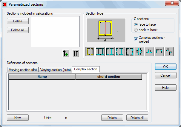

Access the option by clicking the Complex section tab in the Parametrized sections dialog. The following dialog displays:
The dialog provides nine types of the complex sections most often used (sections are selected in the Section type field in the top right part of the dialog box):
- Two C-sections (set face to face or back to back)
- Two I-sections
- C-section and I-section (C-section set face to face or back to back)
- Two angles and I-section
- Four angles set face to face
- Four angles with legs back to back
- Two angles in the shape of 'T' (set with shorter or longer legs back to back)
- Two angles in the shape of 'C' (set with shorter or longer legs face to face)
- Two angles in the shape of a cross.
For some types of complex sections the Complex sections - welded option is available. If selected, then chords of a complex section are joined with welds along the section length.
