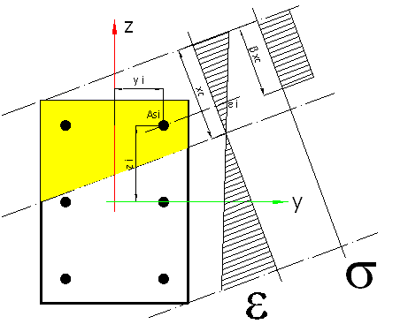

The calculation of the column capacity for biaxial bending proceeds according to the following procedure:
where: Acc is the area of the compression part (according to the diagram of the s distribution), E denotes Young's modulus.
The drawing illustrates the rectangular stress diagram. For some codes the diagram is parabolic-rectangular.
