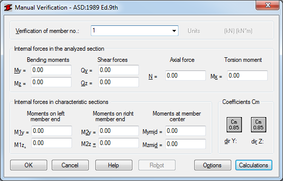

Open the Manual Verification dialog by clicking Design
Steel Members Design - Options
Verification. The following displays:
The Manual Verification dialog is used for manually verifying a steel member for values defined by the user according to the requirements of the American Steel Code ASD. Bar verifications are performed by assigning the force values appropriate for specific calculations. The dialog is divided into two main parts:
To select values from an available load case list, click the Robot button. Appropriate force values will automatically be entered in the corresponding fields of the Manual Verification dialog.
To perform verification of a member based on internal forces entered in the dialog, you should:
Once the Calculations option is selected, member verification will be carried out. After they are completed, a dialog showing the results is displayed.
