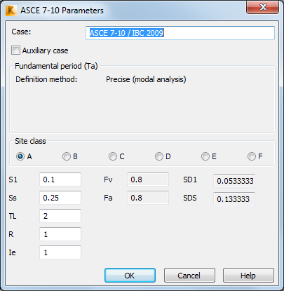

Parameters of the seismic simplified analysis according to the equivalent lateral force method depend on a seismic code and a method of defining values of the fundamental periods selected in the Seismic Analysis dialog.

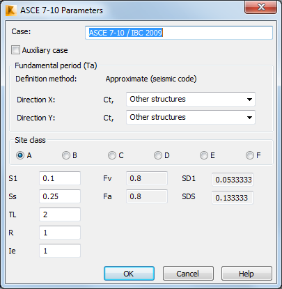

The fundamental period Ta is calculated according to the equation 4.6:
Ta = Ct * hn x
where:
Ct - building period coefficient depending on the type of seismic-force-resisting system that is used (given by the code)
x = building period formula exponent (given by the code)
h - structure height (m), defined by difference between Structure range and Reference level

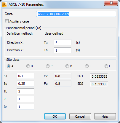

Only Ta on both directions is to be defined.
According to this method you can calculate the exact value for both X and Y directions. If the option Periods with maximal mass participation is off in the Seismic Analysis dialog, the first mode in direction where more masses is active. If this option is on, one of modes, which fulfill limitations and most masses is active in the direction. The maximal period is calculated according to the formula:
