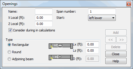

Once the option is chosen, the dialog box shown below will appear on the screen.
Activation of the option from the menu or the toolbar results in the appearance of only the dialog box which is the main tool used to define beam openings.
The following options are available in the above dialog box: Name, Span number, Origin, X Local, Z Local, Type.
Once all the required parameters are defined, pressing the ADD button results in the acceptance of the defined opening and saving of the data. The buttons: << and >> located in the Openings dialog box allow to move about the table containing the data pertaining to all the defined openings.

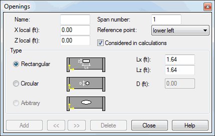

In the case of deep beams, the dialog box that allows one to define openings assumes the shape shown in the figure below:
The above-presented dialog box contains, apart from options discussed for RC beams, the Considered in calculations option. If the option is switched on, the opening will be recognized in calculations foundation deep beam reinforcement. The option for defining an arbitrary opening shape for deep beams is not available in the present release of the program.
