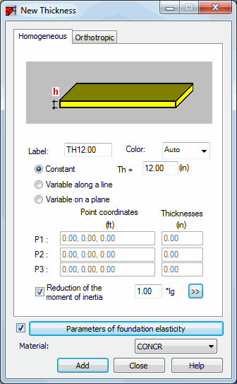

On the Homogenous tab, you define a thickness for a single panel.
Specify homogeneous thickness parameters:
Th field - In this field, type the thickness value for a surface structure element (panel), when a constant thickness was selected along the entire finite element (panel).
Reduction has no effect on the membrane stiffness (compression, tension) and transversal forces. Elements of the bending matrix for finite elements are multiplied by a specified value of the reduction factor.
Reduction of moments of inertia for RC sections is applied in static calculations to account for the influence of section cracks. This method is allowed by the USA codes (UBC 1997 point 1910.11.1 or ACI 318 point10.11.1). Examples of stiffness reduction values according to ACI:
After you have defined the parameters, click Add. The newly defined thickness type will be added to the list of active thickness types.
