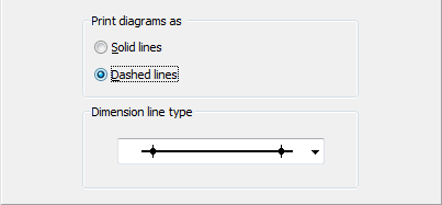

Click Symbols on printouts to select the type of diagram presentation, and the type of dimension line to be applied to printouts.
