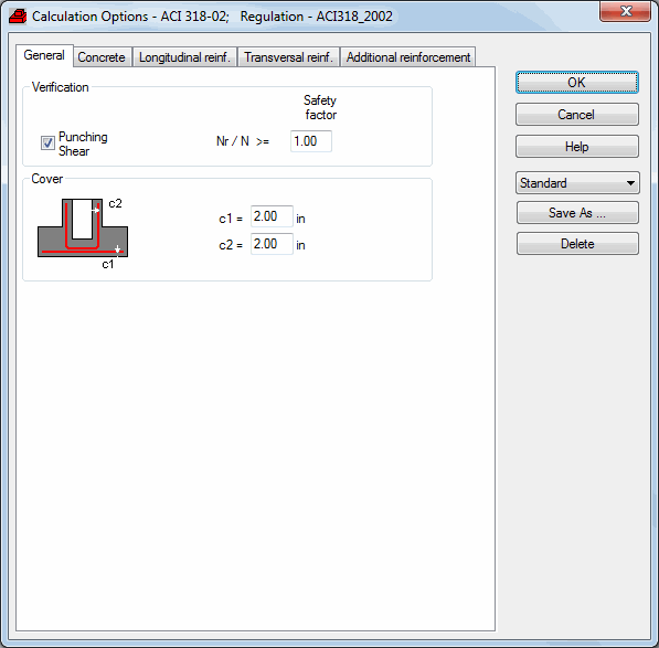

Once the Calculation Options dialog box for foundations is opened and the General tab is selected, the dialog box shown below will appear on the screen.
The options in the dialog box above enable determining values of the reinforcement cover c1 and c2 in a designed foundation.
In addition, depending on a code selected, the following options may be available:
For Eurocode 2, you can use the option that specifies a value of the coefficient of friction for pocket foundations (Section 10.9.6.3) and the Deviations button; click it to open the Cover Deviations dialog.
