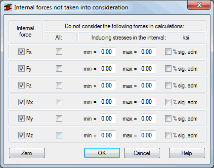

Use this option to determine the limit values of internal forces; thus the force values 'negligible' for a specific section may be disregarded. Access the option by clicking the Exclude internal forces from calculations button in the Configuration dialog.
There are two possibilities for excluding an internal force from the member design.
Click the Zero button to remove settings from all the edit fields.
