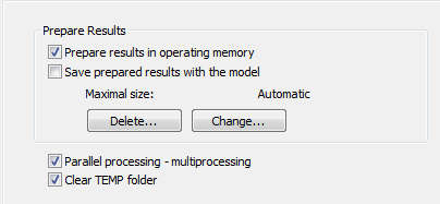

After you click Advanced in the right panel of the Preferences dialog, the following fields display:
The Prepare results field saves results for maps on panels to accelerate their display or printout the next time.
Clicking Change opens an additional dialog.
Use this dialog to specify the maximum disk space needed to save buffers with results. By default, the Automatic support option is turned on, but not all edit fields are available.
User settings determine the maximum size of buffers and the minimum amount of free disk space.
