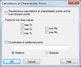

The dialog box shown below is used to define coordinates of the characteristic points; member calculations/verification will be performed for them. The option is available after pressing the Options button in the Configuration dialog box.
In the above dialog box the user may determine the characteristic points for which member calculations will be performed:
If the option Simultaneous calculations in characteristic points and in the even-division points is switched on, then structure member calculations will be performed for both the defined characteristic points (determined in this dialog box) and for the number of calculation points determined in the Configuration dialog box (the Number of points option).
