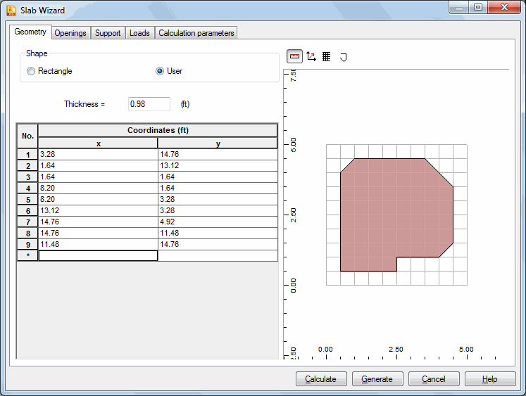

It is possible to define the geometry of slabs as rectangular or user defined.
Rectangular
When defined, the following slab dimensions should be determined:
User defined
When defined, specify the successive nodes of a slab.
Values in the table may be modified; a change of coordinates in the table results in a change of slab geometry in the drawing presented in the dialog.
The top right part of the dialog holds the following tools.
For a slab of a user-defined shape, it is necessary to determine a slab thickness.
