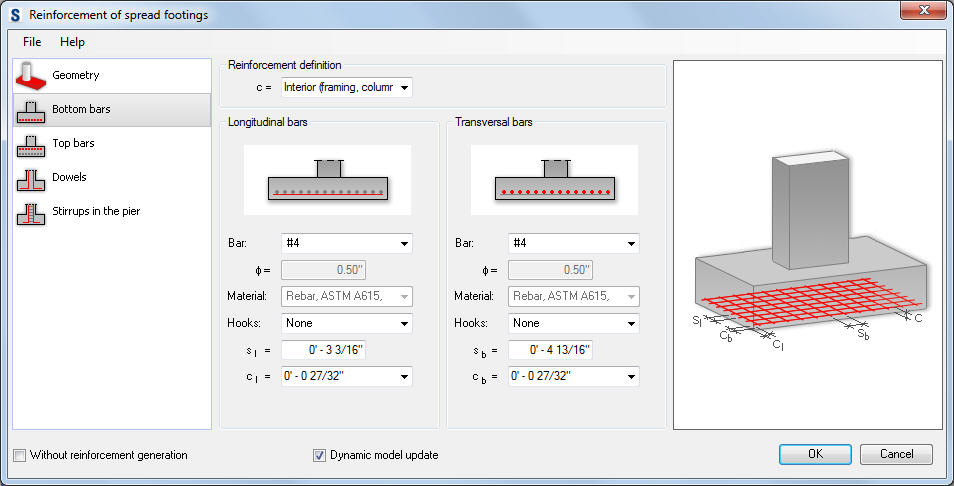

There are several parameters of bottom reinforcement defined in the Reinforcement of spread footing dialog:
Parameters of hooks and bars are loaded from families defined in Revit. A bar diameter and material are associated with a selected steel grade (family).
