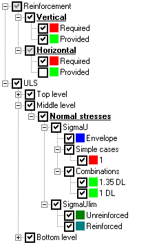

Management of results to be presented on diagrams is possible due to options in the tree in the right-hand part of the Wall - results layout.
A selected diagram or a group of diagrams displays after activating the field located to the left of a selected option and clicking the Apply button (or pressing Enter).
Bold faced components correspond to the generation of separate diagrams. It means that if two marked components are chosen, two separated diagrams will be presented. Results on lower levels of a given category are displayed on one diagram for this category.
A color of any diagram may be changed by double-clicking the field presenting the color of a diagram in the dialog box for result management.
