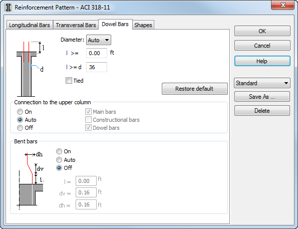

The Dowels Bars tab allows you to assign dowels to the upper column.
Select RC Design
Provided reinforcement layout, and then create a new RC element or open an existing one.
Reinforcement Pattern.
(Reinforcement Pattern).
Defines the diameter and total length of the extension of a dowel bar.
The Tied option allows you to select if all dowel bars should be tied or not.
The following options are available:
Off - connecting reinforcement will not be generated even if there is the upper column.
Additionally, it is possible to select which bars should be extended (main, constructional) and to decide if additional dowel bars should be used.
The Save As option allows you to reuse a set of reinforcement pattern parameters. This set is saved to your current user directory. You can reuse this set for the other element in the Reinforcement Pattern dialog or assign it to the selected element (or selected elements of the same type) in the RC Component Inspector.
The Delete option allows you to remove the selected set of reinforcement pattern parameters.
