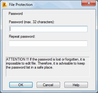

Select Tools > Password Protection to block access to an *.rtd file in the case where the file with results is sent by a client for verification or viewing.
A password includes any combination of letters and digits. The password may not exceed 32 characters.
A defined password should be kept in a safe place. A file is inaccessible if the password is forgotten.
