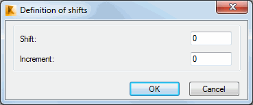

An initial shift value is entered to the Shift edit field. Increment parameter determines the number of iterations performed during modification of the shift. For example, if the increment is 5 and the convergence of an arbitrary eigenvalue is not obtained within 5 iterations, then the shift value will be changed in the manner shown by the following formula.

You can use a variable shift value (when the increment value is greater than or equal to zero) to accelerate convergence. A shift value will be changing as shown by the equation (2). This method of calculations is recommended when convergence is slow. However, it should be remembered, that each change in a shift value causes repeated factorization of Kσ matrix; therefore, a shift value should not be modified too often.
Application of a constant shift value (when increment = 0) changes position of the convergence center to the value of the assumed shift σ.
