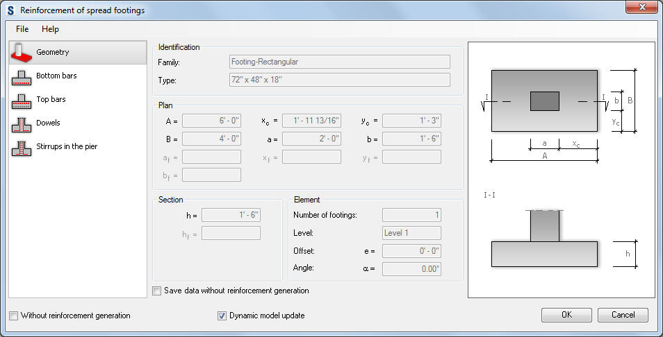

Reinforcement of Spread Footings - launched from Autodesk® Revit®.
Parameters of the spread footing geometry include:
Allowable shapes of a spread footing and the column:
simple rectangle
double rectangle
trapezoid If the Save data without reinforcement generation option is cleared, the reinforcing bars are generated and displayed in Autodesk® Revit®. If this option is selected, the reinforcement data is generated (and can be used after restarting the Extension), but reinforcing bars cannot be displayed in Autodesk® Revit®.

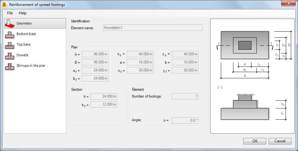

Reinforcement of Spread Footings - launched from Autodesk Robot Structural Analysis 2015.
Specify the following data in the upper part of the dialog:

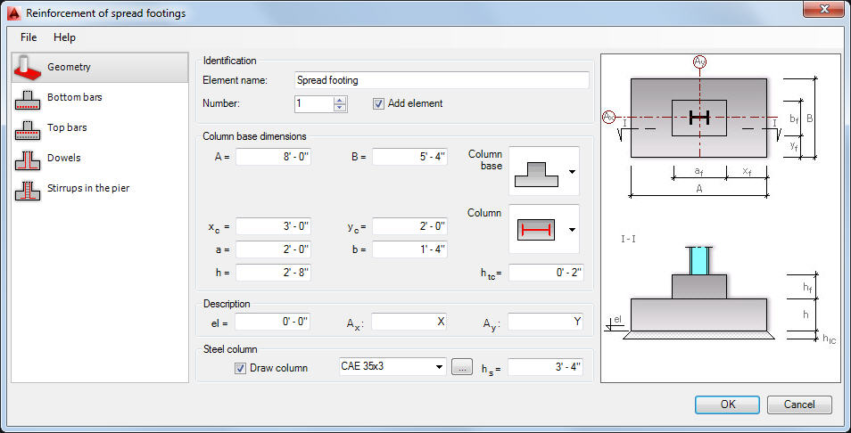

Reinforcement of Spread Footings - launched from Autodesk® AutoCAD® Structural Detailing 2015 - Reinforcement.

Steel column. If you select the Add element option, reinforcing bars (or wire fabrics) are grouped in an element while generating reinforcement for the spread footing; a name of this element (specified in the Element name field) is added on the Model tab in the Object Inspector dialog in Autodesk® AutoCAD® Structural Detailing 2015 - Reinforcement.
After defining the spread footing geometry, specify values of dimensions for the spread footing and the pier of the adjoining column; the schematic drawing of the spread footing adjusts to selected shapes of the spread footing and the column.
Moreover, you can specify the following parameters:
Options in the Steel column field are available if a steel column is selected. Select Draw column to include a steel column with a selected section in a drawing of the spread footing. The length of the steel column is specified in the hs field.
