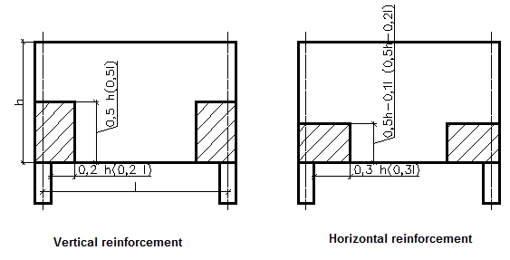

Dimensions of near-support zones depend on the geometry and support method of a deep beam.
Deep beam supported by columns, with one span
Values in parentheses are given for h ≥ 2l.

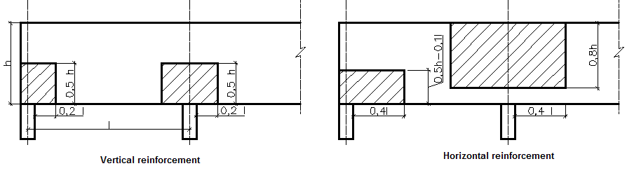

Deep beam supported by columns, with several spans, for h ≥ l/2
Values in parentheses are given for h ≥ l.

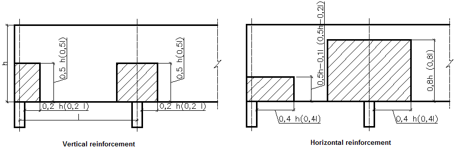

Deep beam supported by columns, with several spans, for h < l/2

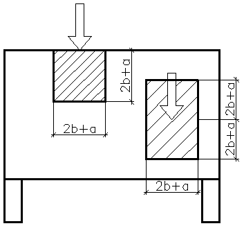

Dimensions of a reinforcement zone where a concentrated force is applied are determined as follows.
Designations in the drawing:
a - Width of load distribution (defined along with a force value).
b - Thickness of a deep-beam.
Simultaneously, the dimension of such zone must be greater than 1 meter.
