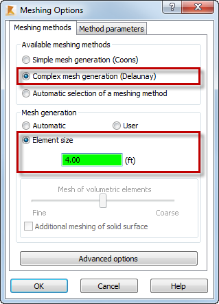

    The Meshing Options dialog opens.
  3. In the Meshing Options dialog, set the following parameters:
    • Available meshing method: Complex mesh generation (Delaunay),
    • Mesh generation: Element size, and then type 4.00.
  4. Click OK.

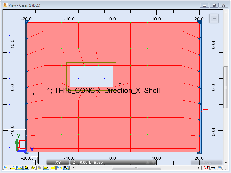

    The panel is highlighted in red.
  5. Click Analysis Generation of computational model.
    The generation process displays in the Calculations dialog, and then the computational model appears in the view.

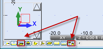

  6. Click (Panel descriptions) and (Calculation model (finite elements)) at the bottom of the drawing area to hide the descriptions of the panel and the calculation model.
