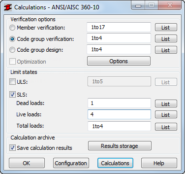

  2. In the Calculations dialog, select Code group verification option, and then type "1to4" in the same line.
  3. In the Limit states group of options select SLS, in order to perform calculations for the service limit state, and then type the following loads:
    • Dead loads: "1",
    • Live loads: "4",
    • Total loads: "1to4".
  4. In the Calculations dialog, click Calculations.

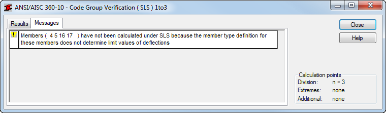

  5. The Code Group Verification dialog opens displaying the most significant information about the sections. The Messages tab (as shown below), contains important information for the next steps in the design process:
    Note: The Member Type for Bracings does not determine limit values for deflections. The next step explains how to set these parameters in order to perform the verification as required.

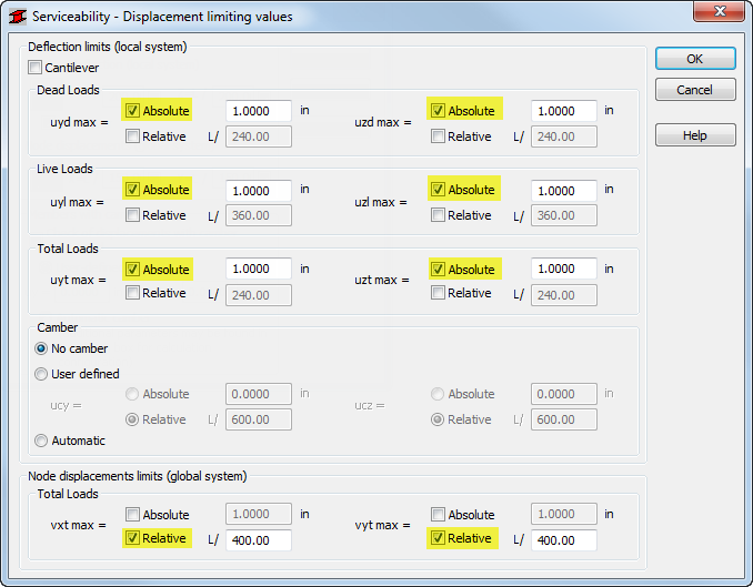

  9. Type Simple bar_1 in the Member type text box, and then click Service.
    The Serviceability - Displacement limiting values dialog opens.
  10. Select the following values:
    • In the Deflection limits (local system) group of options, select the Absolute value for Dead, Live and Total Loads,
    • In the Node displacement limits (global system) group of options, select the Relative value for Total Loads.
  11. Click OK.

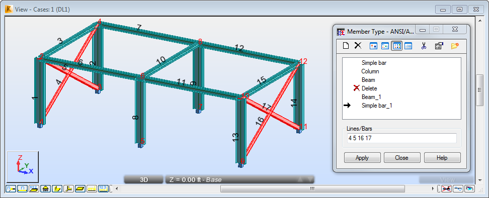

  13. Ensure that Simple bar_1 is selected, type "4 5 16 17" in the Lines/Bars field as shown below.
    Alternatively, place the cursor in the Lines/Bars field, then go to the drawing area, and hold the Ctrl key to select bracings with numbers 4, 5, 16 and 17.
  14. Click Apply, and then click Close.

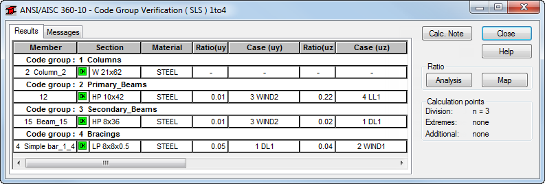

  15. In the Calculation dialog, click Calculation.
    Results of the Code Group Verification are shown below.
    Note: All sections are now properly defined for all the groups of members.

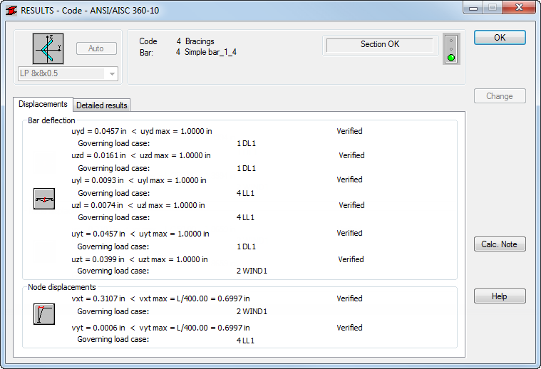

  16. To visualize the detailed results for a selected group, click 4 Simple bar_1_4 in the Bracings group.
    The row is highlighted in black and the Results dialog is displayed:
  17. Review the results, and then Click OK.
