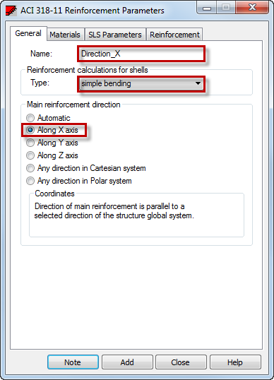

The ACI 318-11 Reinforcement Parameters dialog opens.

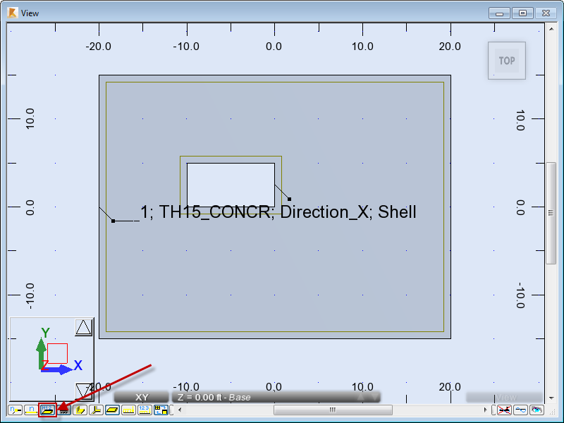

The new reinforcement type appears on the list as shown below:

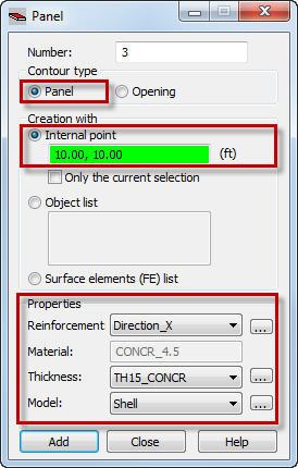

The Panel dialog opens.

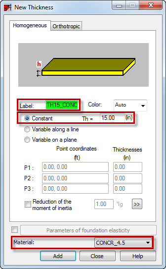

The New Thickness dialog opens.
The new thickness TH15_CONCR should be automatically selected in the Thickness list.
