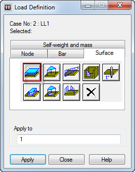

Click (LoadsLoad Definition).
The Load Definition dialog opens.

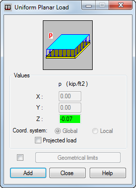

Go to the Surface tab, and click (Uniform Planar Load).
The Uniform Planar Load dialog opens.
Enter -0.07 in the PZ: box, and then click Add.
Place the cursor in the Apply to box, and type 1 to indicate the plate on which you want to apply a uniform planar load.
Alternatively, you can select the plate graphically. To do it, go to the drawing area, and then the icon appears which allows you to select the plate.
Click Apply.

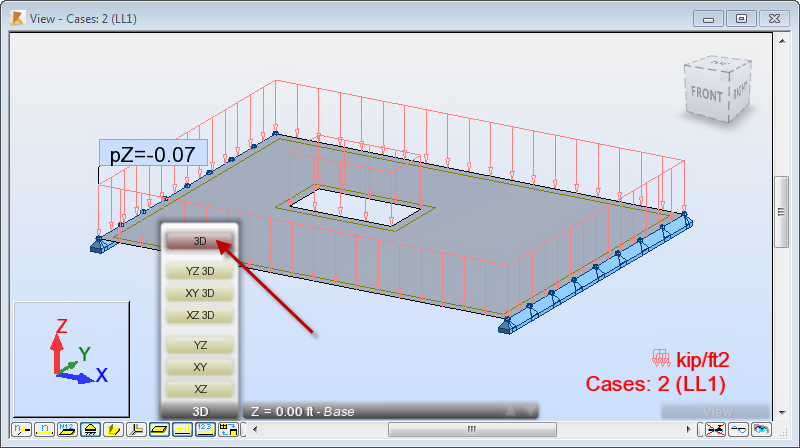

The LL1 load appears in the drawing area.
Click (Load value descriptions) at the bottom of the drawing area to display the descriptions of loads values.
At the bottom of the drawing area, expand the list of views, and then select the 3D view.

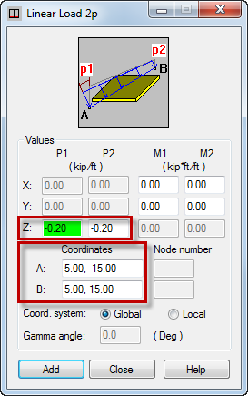

Go to the Load Definition dialog, and then in the Surface tab, click (Linear Load 2P).
The Linear Load 2P dialog opens.
In the Linear Load 2P dialog set the following parameters:
P1=P2: - 0.20,
Coordinates: A: (5.00,-15.00) and B: (5.00, 15.00).
Click Add.

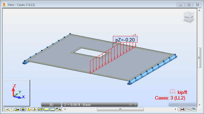

The LL2 load appears in the drawing area.

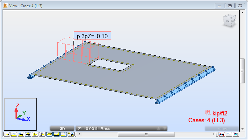

In the Cases Selection box of the Selection toolbar, expand the Cases drop-down menu and select 4: LL3.

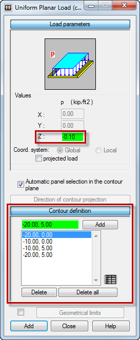

Go to the Load Definition dialog, and then in the Surface tab, click (Uniform Planar Load on Contour).
The Uniform Planar Load on Contour dialog opens.
Enter - 0.10 in the PZ: box.
Click Contour definition.
The Contour definition area expands.
To create the contour for the load, enter the following point coordinates:
(-20.00, 0.00), click Add,
(-10.00, 0.00), click Add,
(-10.00, 5.00), click Add,
(-20.00, 5.00), click Add.
Click Add.
The LL3 load appears in the drawing area.

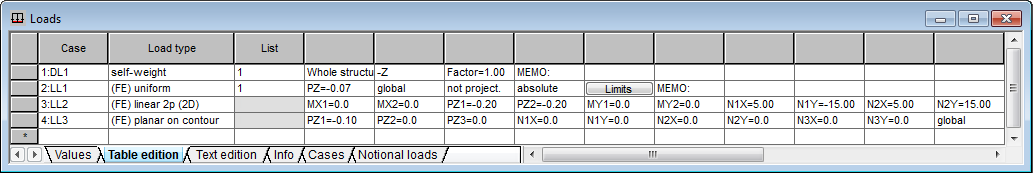

Click Loads Load Table to open the Loads table.
Alternatively, click (Tables) in the Structure Model toolbar on the right side of the program to open the Tables: Data and Results dialog. Then select Loads and click OK.
The Loads table opens.
Ensure that you have the same properties of loads as shown below:
Tip: You can use the Loads table to modify the defined loads. For example, you can change the loads types, the list of elements where loads are applied and the values of these loads. You can also use this table to add new loads to the structure.
