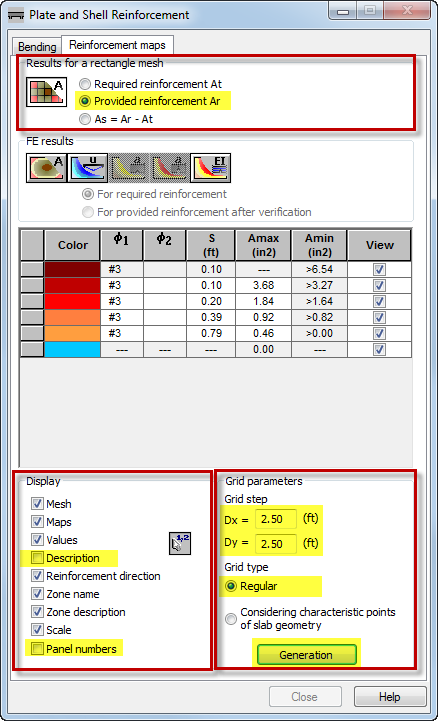

  10. To display the provided reinforcement maps, go to the Plate and Shell Reinforcement dialog. Click the Reinforcement maps tab, and then in the Results for a rectangle mesh group select Provided reinforcement Ar.
  11. To improve the visibility of the reinforcement maps, go to the Display group, and then deselect Description and Panel numbers.
  12. To adjust the grids of the reinforcement maps to the plate, go to the Grid parameters group, and then set the following properties:
    • Grid step: Dx=Dy=2.50,
    • Grid type: Regular,
    • Click Generation.

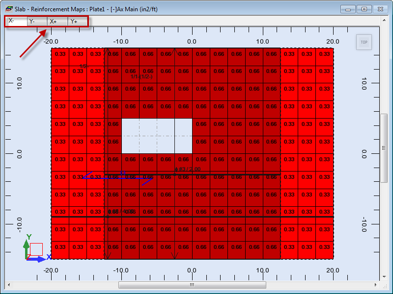

    The bottom provided reinforcement area for the X direction displays in the view. To view the reinforcement for other directions, in the top left corner of the screen select another tab e.g. Y-.
    Note: As you can see, the largest amount of the provided reinforcement is located in the middle of the plate, therefore the results are appropriate regarding the opening and the method of plate support.
