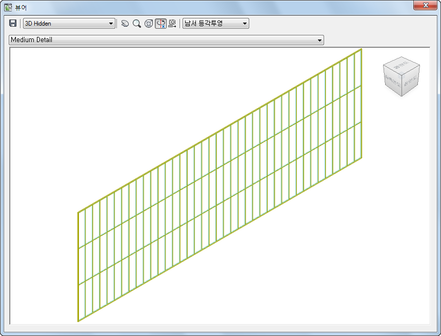

You can preview the effects of a style that you are creating in the Object Viewer (Floating Viewer) provided with Style Manager.
. Find Alternatively, you can click the
button (Inline Edit Toggle) to display the Object Viewer embedded inside Style Manager.

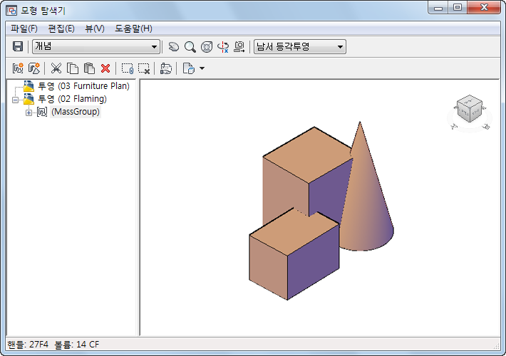

The Model Explorer is a window in which you create, view, and manipulate mass elements and mass groups. The Model Explorer uses the Object Viewer to let you preview the mass element and mass group operations you perform.

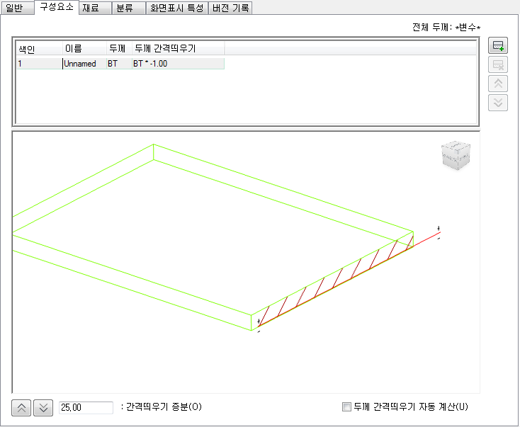

Embedded Object Viewer in Roof Slab style tab

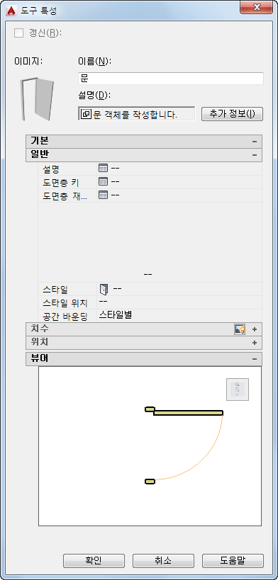

Embedded Object Viewer in tool properties
