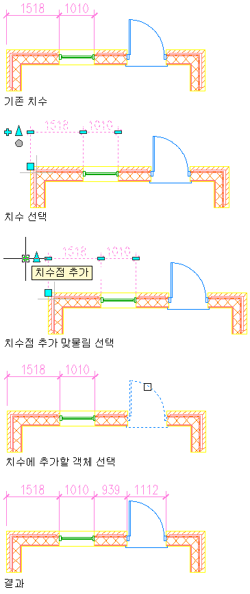

Find. Any dimension points specified in the style for the selected objects are added to the chains of the AEC dimension.
If a selected object has no dimension points specified in the AEC dimension style, a dimension point is added at the base point of the object.
