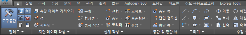

Commands available from the ribbon are organized into tabs. Each tab is organized into a series of panels, which are labeled by task.
The ribbon is typically turned on (displayed) by default, and can be displayed or removed using the Ribbon and RibbonClose commands.
There are two basic types of ribbon tabs: static and contextual.
Static Ribbon Tabs
Static ribbon tabs are always displayed when the ribbon is turned on, and they contain most of the functionality located on the menu bar drop-down menus and toolbars. Static ribbon tabs have a gray background color.

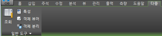

Multiple Object Select Ribbon Tabs
When multiple types of objects are selected simultaneously, the Multiple contextual tab is displayed in the ribbon. For example, if you select both a pipe network object and an alignment object, the Multiple contextual tab is displayed.
