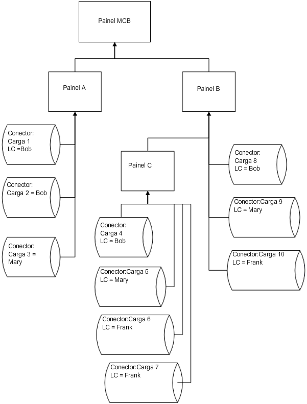

Exemplo de cargas conectadas e cálculos
Para Painel C
LC Bob
LC Mary
LC Frank
Luzes do grupo LC
Carga conectada total (painel C) = (4 + 5 + 6 + 7)
Total de carga de demanda (painel C) = DFBob * (4) + DFMary * (5) + DFFrank * (6 + 7)
- Carga conectada total = 4
- Total de carga de demanda = DFBob * (4)
- Carga conectada total = 5
- Total de demanda = DFMary * (5)
- Carga conectada total = (6 + 7)
- Total de carga de demanda = DFFrank * (6 + 7)
- Carga conectada total = (5 + 6 + 7)
- Total de carga de demanda = (painel C) = DFBob * (4) + DFMary * (5) + DFFrank * (6 + 7)
Para Painel B
LC Bob
LC Mary
LC Frank
Luzes do grupo LC
Carga conectada total (Painel B) = (4 + 5 + 6 + 7 + 8 e 9 + 10)
Total de carga de demanda (Painel B) = DFBob * (4 + 8) + DFMary * (1 + 9) + DFFrank * (6 + 7 + 10)
- Carga conectada total = (4 + 8)
- Total de carga de demanda = DFBob * (4 + 8)
- Carga conectada total = (5 + 9)
- Total de demanda = DFMary * (1 + 9)
- Carga conectada total = (6 + 7 + 10)
- Total de carga de demanda = DFFrank * (6 + 7 + 10)
- Carga conectada total = (5 + 6 + 7 + 9 + 10)
Para Painel A
LC Bob
LC Mary
LC Frank
Luzes do grupo LC
Carga conectada total (painel a) = (1 + 2 + 3)
Total de carga de demanda (painel a) = DFBob * (1 + 2) + DFMary * 3
- Carga conectada total = (1 + 2)
- Total de carga de demanda = DFBob * (1 + 2)
- Carga conectada total = 3
- Carga conectada total = 0
- Total de carga de demanda = 0
Para Painel MCB
LC Bob
LC Mary
LC Frank
Luzes do grupo LC
Carga conectada total (Painel MCB) = (1 + 2 + 3 + 4 + 5 + 6 + 7 + 8 e 9 + 10)
Total de carga de demanda (Painel MCB) = DFBob * (1 + 2 + 4 + 8) + DFMary * (3 + 5 + 9) + DFFrank * (6 + 7 + 10)
- Carga conectada total = (1 + 2 + 4 + 8)
- Total de carga de demanda = DFBob * (1 + 2 + 4 + 8)
- Carga conectada total = (3 + 5 + 9)
- Total de demanda = DFMary * (3 + 5 + 9)
- Total de carga de demanda = DFMary * (1 + 9) + DFFrank * (6 + 7 + 10)
